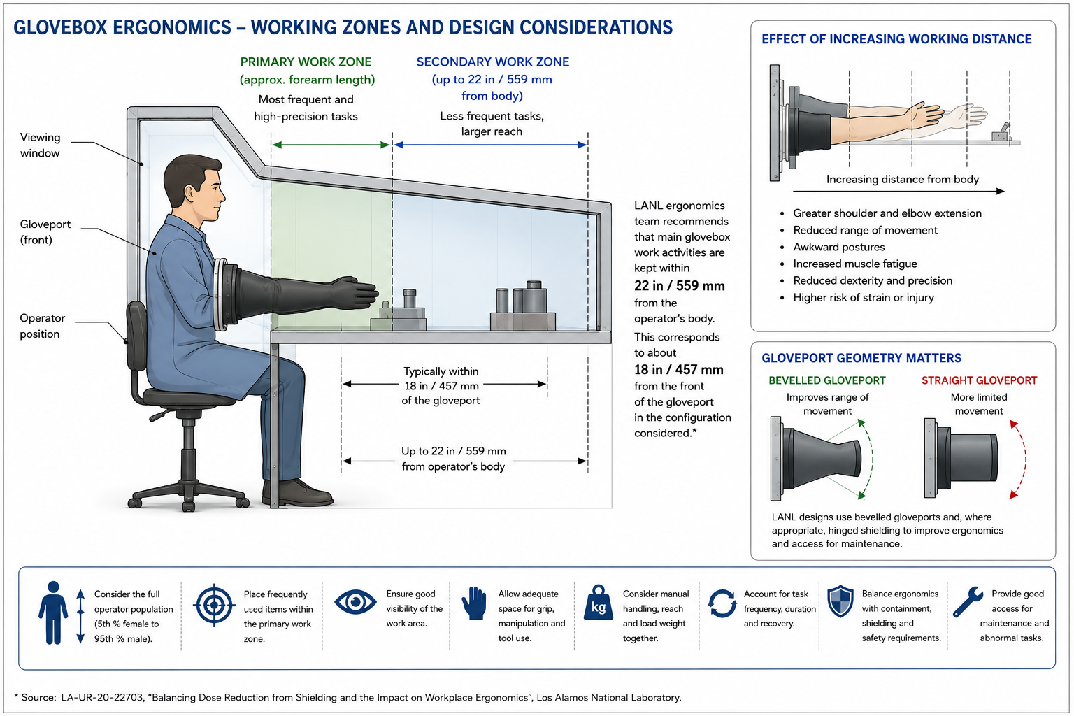

Glovebox ergonomics diagram showing operator working zones, reach distance, gloveport configuration and ergonomic design considerations
Glovebox ergonomic design considerations including working reach, gloveport position, posture, dexterity and manual handling. Diagram based on publicly released LANL ergonomic research.

Glovebox Working Reach
Working distance is particularly important during glovebox operation. As the work moves farther from the operator, greater arm extension may be required and the ability to reposition the shoulder and elbow can become increasingly restricted.
A publicly released LANL study describes the ergonomic primary work zone as approximately the length of the forearm. The same work discusses a secondary work zone extending to approximately 22 in (559 mm) from the operator's body, with glovebox tasks normally positioned within this working region where practicable.
The LANL publication also relates this working zone to approximately 18 in (457 mm) from the front of the gloveport for the configuration considered in the study.
Source: J. Mann, J. Linn, M. Chan and L. Hetrick, Balancing Dose Reduction from Shielding and the Impact on Workplace Ergonomics, Los Alamos National Laboratory, LA-UR-20-22703.
These dimensions should be regarded as published LANL ergonomic guidance rather than universal glovebox design limits. The appropriate working distance depends on the operator population, glovebox geometry and the task being performed.

Gloveport Position and Operator Posture
The gloveport forms a fixed interface between the operator and the work. Its position influences shoulder posture, elbow position, reach and the operator's ability to apply force inside the glovebox.
LANL research into glovebox shielding demonstrates an important engineering effect: increasing the distance between the operator and the glovebox can alter the available shoulder and elbow movement and increase the reach required to perform a task.
Consequently, glovebox depth and gloveport position should not be considered independently. The location of frequently used tools, components and controls inside the enclosure is also part of the ergonomic design.
