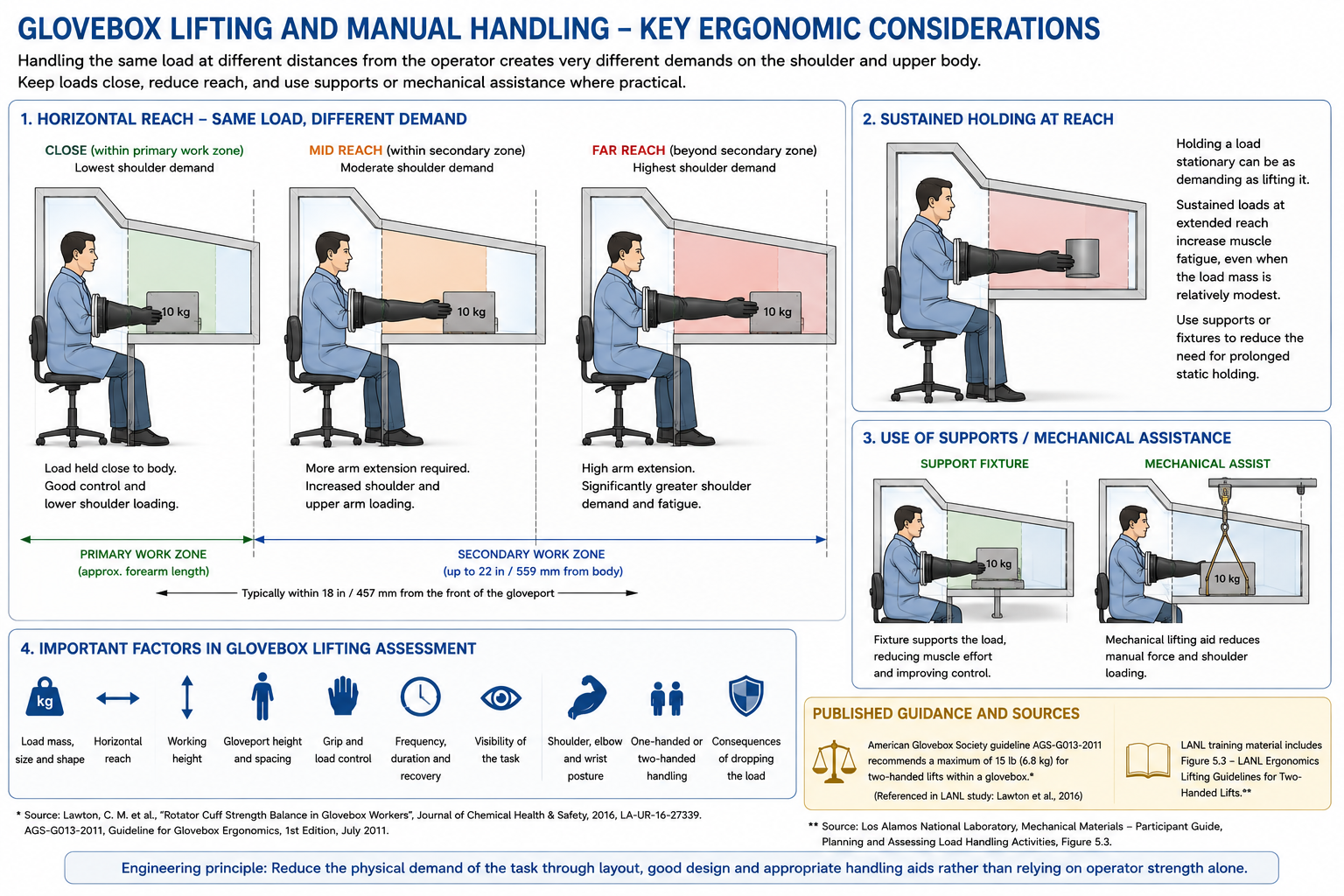

Lifting and handling an object inside a glovebox can impose different physical demands from handling the same object in an unrestricted workplace. The operator cannot normally move the whole body freely towards the load because the arms are constrained by fixed gloveports.
Load weight is therefore only one part of a glovebox manual-handling assessment. Horizontal reach, working height, shoulder and elbow posture, grip, task frequency, duration and the ability to support or mechanically assist the load should also be considered.
Glovebox lifting and manual handling diagram showing the effect of horizontal reach, sustained holding, support fixtures and mechanical lifting assistance
Glovebox lifting and manual-handling considerations. Increasing horizontal reach increases the physical demand of handling a load, while fixtures and mechanical assistance can reduce sustained muscular effort. Based on publicly released LANL research and published glovebox ergonomics guidance referenced by LANL.

The physical demand of a lift depends strongly on where the load is located relative to the operator. A relatively light object positioned close to the hands may be straightforward to manipulate, while the same object at extended reach can place substantially greater demand on the shoulder.
This relationship is particularly important in glovebox work because the operator cannot simply step closer to the load.
Frequently lifted objects should therefore be positioned within a favourable working region where practicable. Heavy, awkward or frequently manipulated items should not be routinely located near the maximum extent of the operator's reach.

Holding an object stationary can be as important ergonomically as moving it. A component may need to be supported while another operation is performed, aligned with another part or manipulated using a tool.
Static loading can produce fatigue even where the load itself appears relatively modest. The required holding time should therefore be considered alongside the mass of the object and its distance from the operator.
Where a component must be supported for an appreciable period, fixtures, supports, trays, stands or other suitable handling aids may reduce the need for sustained muscular effort.

Mechanical Assistance and Fixtures
Where a task requires repeated lifting, sustained holding or manipulation of a relatively heavy component, engineering controls should be considered before relying solely on operator strength.
Possible approaches include:
  • supporting or locating fixtures;
  • sliding or rolling trays;
  • component stands;
  • counterbalanced handling arrangements;
  • mechanical lifting assistance;
  • reducing component mass where practicable;
  • dividing an assembly into more manageable parts; and
  • repositioning frequently handled components closer to the operator.
The suitability of any handling aid will depend on the glovebox design and the applicable containment, safety, process and operational requirements.
