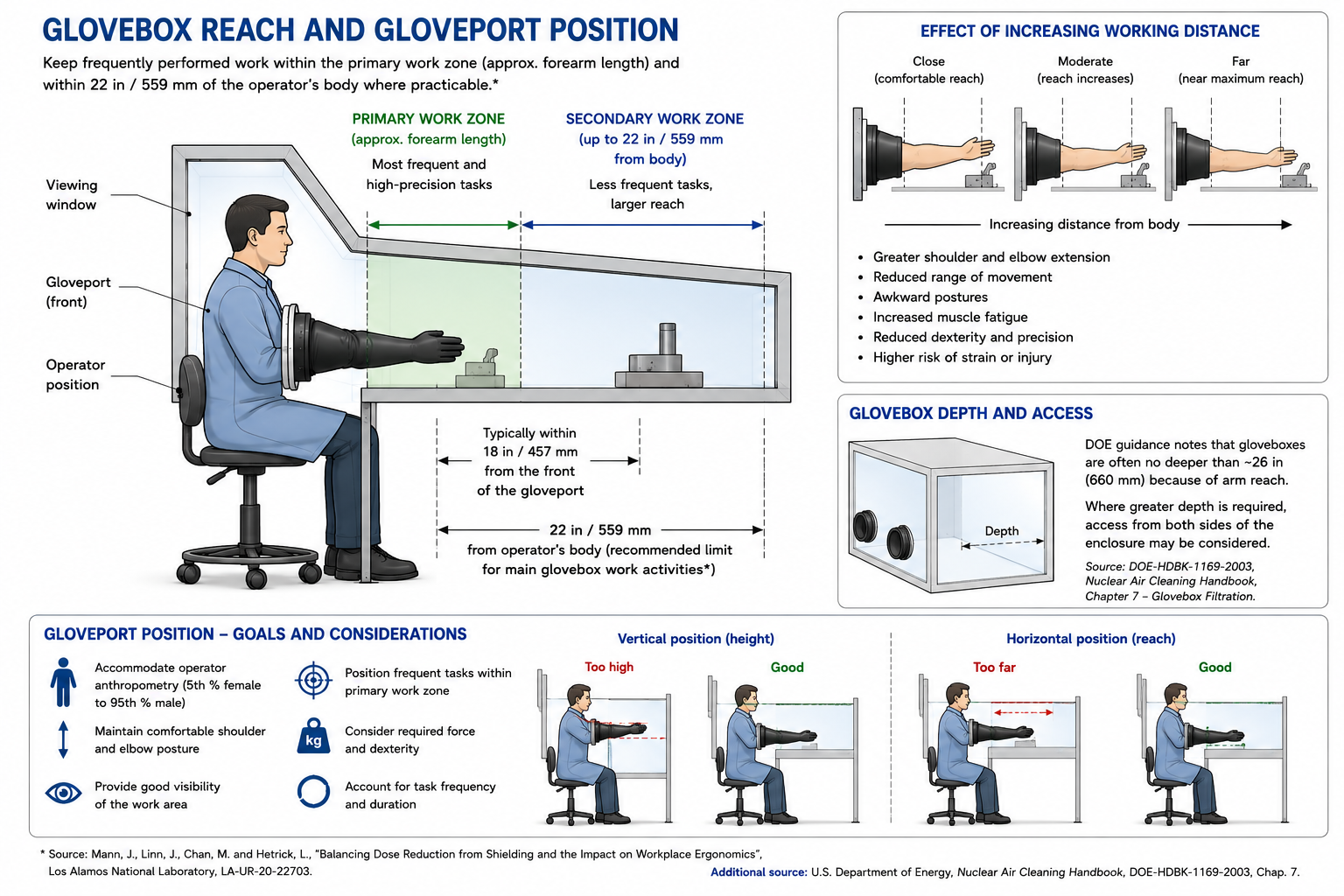

Glovebox reach differs from normal workstation reach because the operator's arms pass through fixed gloveports. The position and geometry of these ports, the depth of the enclosure and the position of the work can restrict shoulder and elbow movement and determine the posture required to perform a task.
Frequently performed or precision work should therefore be positioned with consideration of the operator's natural working reach rather than simply placed wherever space is available inside the enclosure.
Glovebox reach and gloveport position diagram showing primary and secondary working zones, working distance, glovebox depth and ergonomic positioning
Glovebox working reach and gloveport design considerations. Working-zone guidance is based on publicly released LANL research (LA-UR-20-22703), with additional glovebox-depth guidance from DOE-HDBK-1169-2003.
Glovebox Working Zones
A useful ergonomic principle is to keep frequently performed work close to the operator and within a comfortable range of arm movement.
In the publicly released LANL paper Balancing Dose Reduction from Shielding and the Impact on Workplace Ergonomics, the primary work zone is described as approximately the length of the forearm.
The LANL ergonomics team recommends that main glovebox work activities are kept within approximately 22 in (559 mm) of the worker's body. The paper describes this as the secondary work zone and notes that it is usually within approximately 18 in (457 mm) from the front of the gloveport.

Effect of Increasing Working Distance
Increasing the horizontal distance between the operator and the work requires greater arm extension. In unrestricted work the operator can often compensate by moving closer to the task or repositioning the body. A glovebox restricts this movement because the arms pass through fixed gloveports.
LANL research identifies the resulting reduction in usable shoulder and elbow movement as an important ergonomic consideration. As working distance increases, awkward upper-extremity postures can occur earlier and operator discomfort and fatigue may increase.

The usable depth of a glovebox is related to human reach. Increasing enclosure depth may provide additional process space, but that space has limited value if the operator cannot comfortably reach the equipment positioned within it.
The U.S. Department of Energy Nuclear Air Cleaning Handbook notes that gloveboxes are often no deeper than approximately 26 in (660 mm), reflecting the distance most arms can reach. Where greater depth is necessary, access from both sides of the enclosure may be considered.

The gloveport establishes the position from which the arm enters the enclosure. Its height, horizontal position and orientation therefore affect the posture of the shoulder, elbow and wrist.
A poorly positioned port can require the operator to raise or lower the shoulder, abduct the upper arm, extend the elbow or deviate the wrist before the task itself begins. The effect can become more significant when the task is repetitive, requires force or must be maintained for an extended period.
